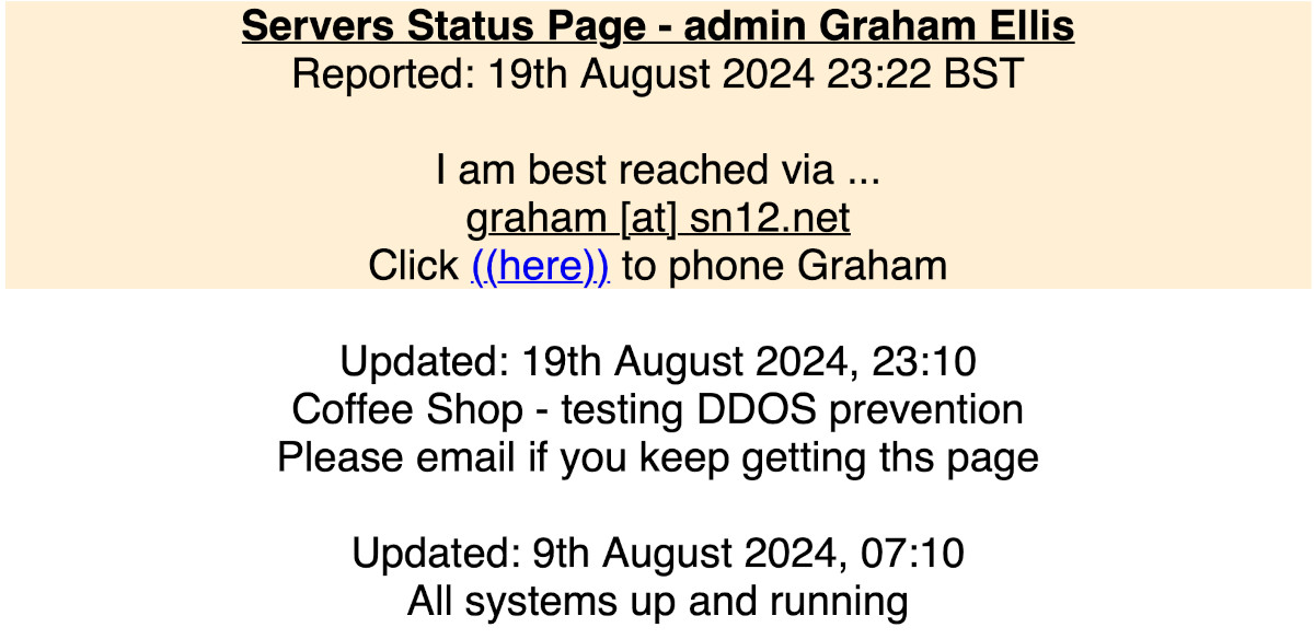

Posted by grahame at 23:32, 19th August 2024
I noticed the other day we clocked up the most ever "visitors" at the same time on the 6th August with 1936 on line.   Shame when things like this skew the real picture.
I think we're down to around 15% of that
If you're genuinely here and see this occasionally - please let me know as it would mean I have overdone the hard shell protecting us

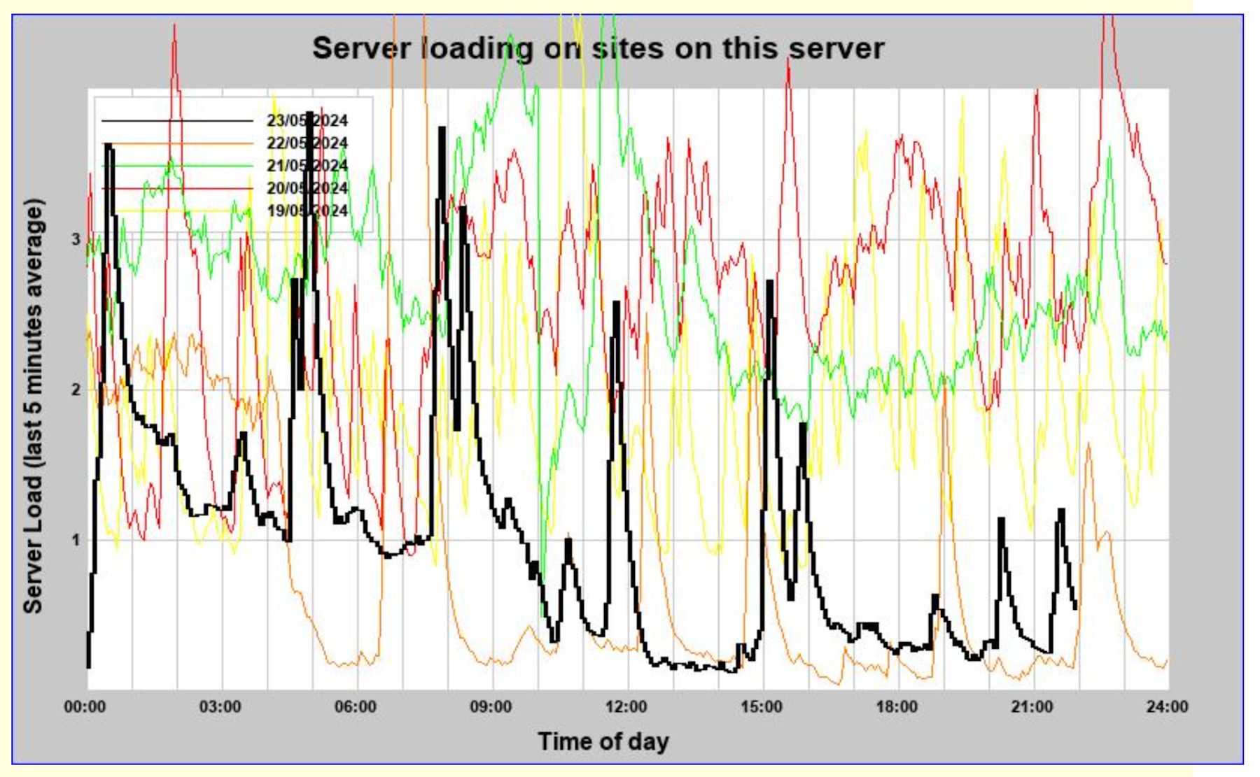

Here is where we were a week ago:
Server load (just one of a number of monitors) from last night - ideally it should be at or below 1 job queuing at any time
The hard black line is yesterday ... the coloured lines are previous days
Here we are now:
And I'm much happier with how that has settled.
